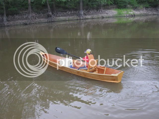

My Granson and boat. He was 7 and not too big for his age. The boat is 14'- 8" OL X 28" beam, 10.5" sides if I recall correctly.
