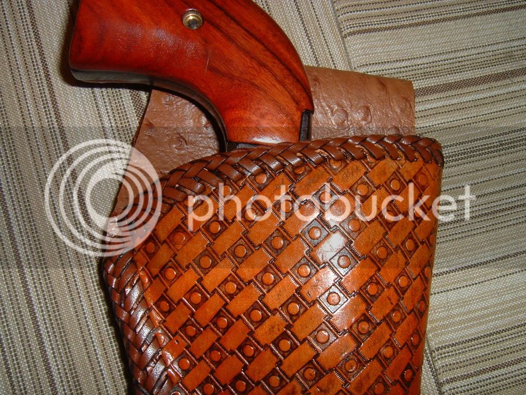

Just a couple of recent projects. Lots of fun.

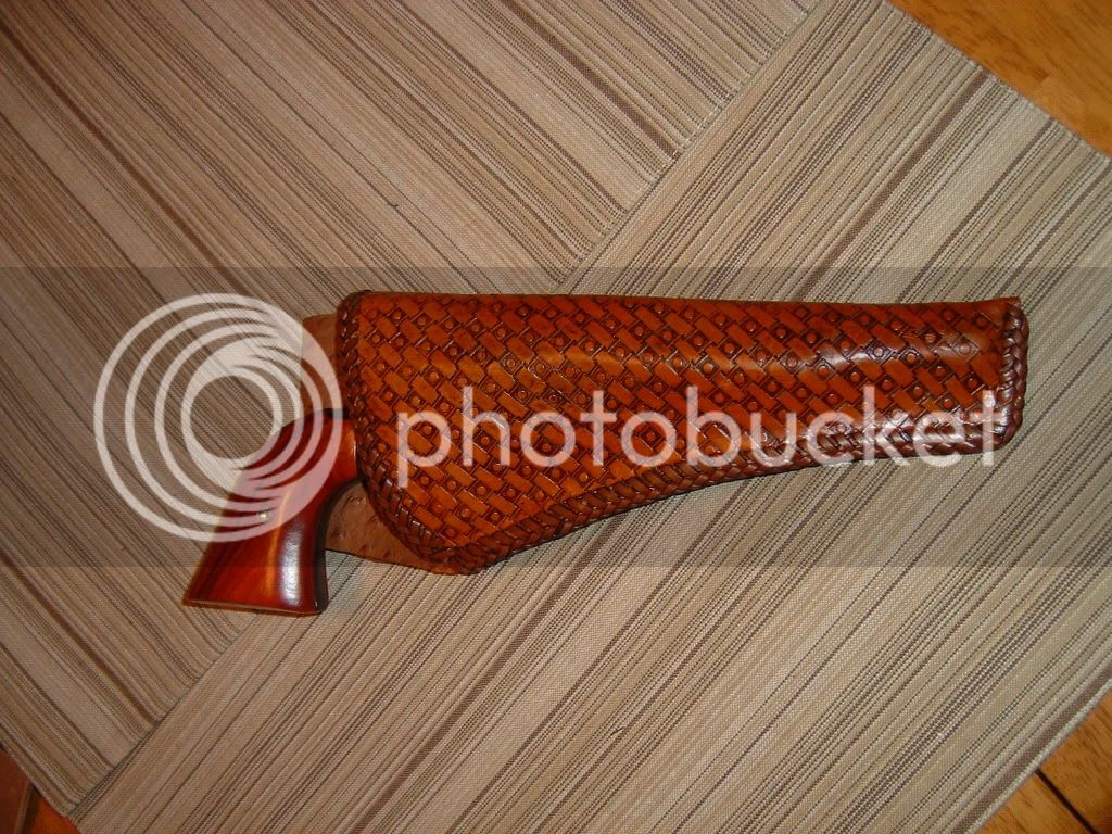

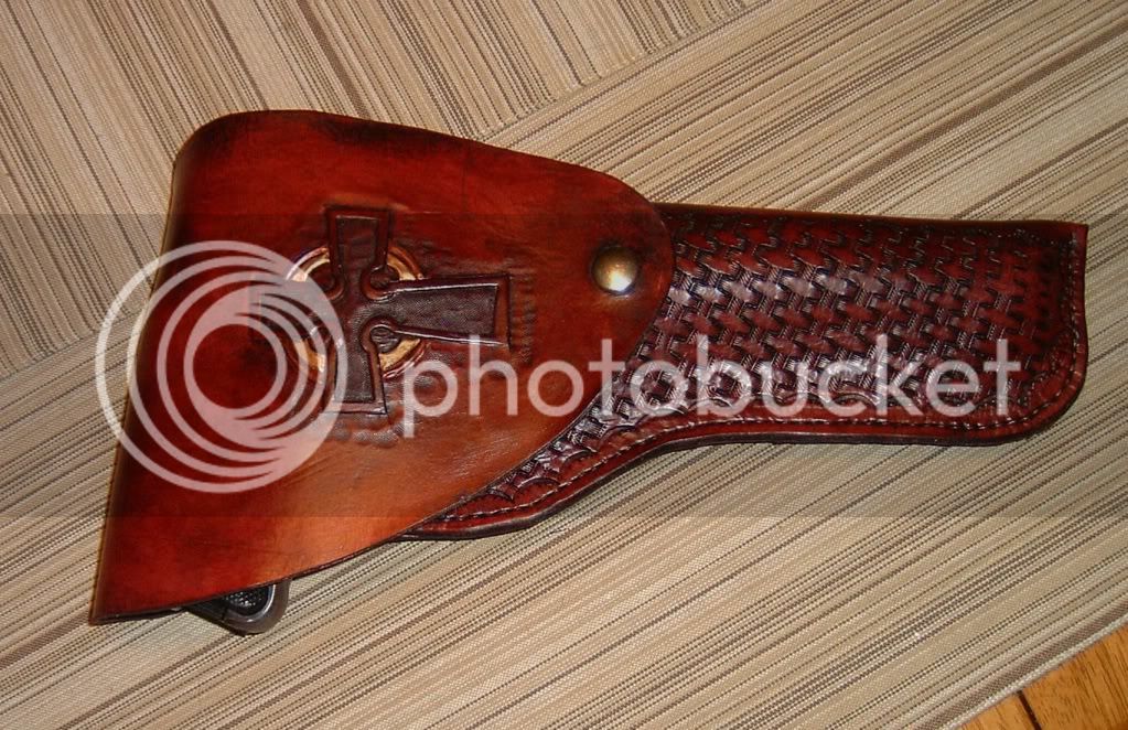

Notice that the hammer is completely enclosed......I did this after our own Kayak Jack told a story about hooking the hammer of his pistol on a tree branch out in the boondocks. That might explain some of his gray hair.
That was on a manzanita bush in the Sierra's, on the North Fork of the American River, just above Rucky Chucky rapids. Having the hammer covered is good; I had the leather opened up around my trigger.
I like the way you've formed the leather around the cylinder of the .44. That way, a holster grips a gun to keep it from bouncing out. I'd oil my gun and wrap it in plastic wrap, soak the holster in hot water, insert the gun, and handwork leather in around all nooks and crannies of the gun - pressing it tightly, and let it dry like that. After it had a good grip around the gun, I'd lightly lube the upper part of a holster with Vaseline and graphite.

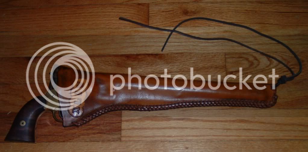

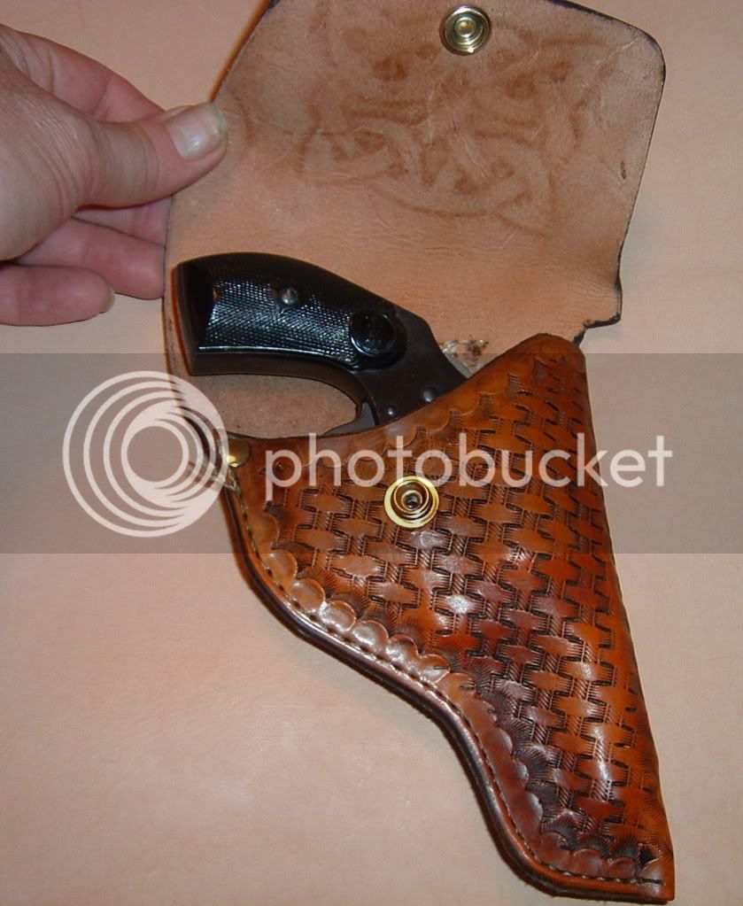

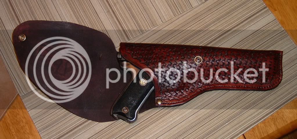

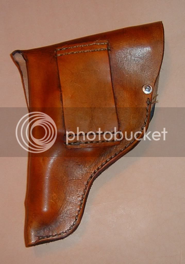

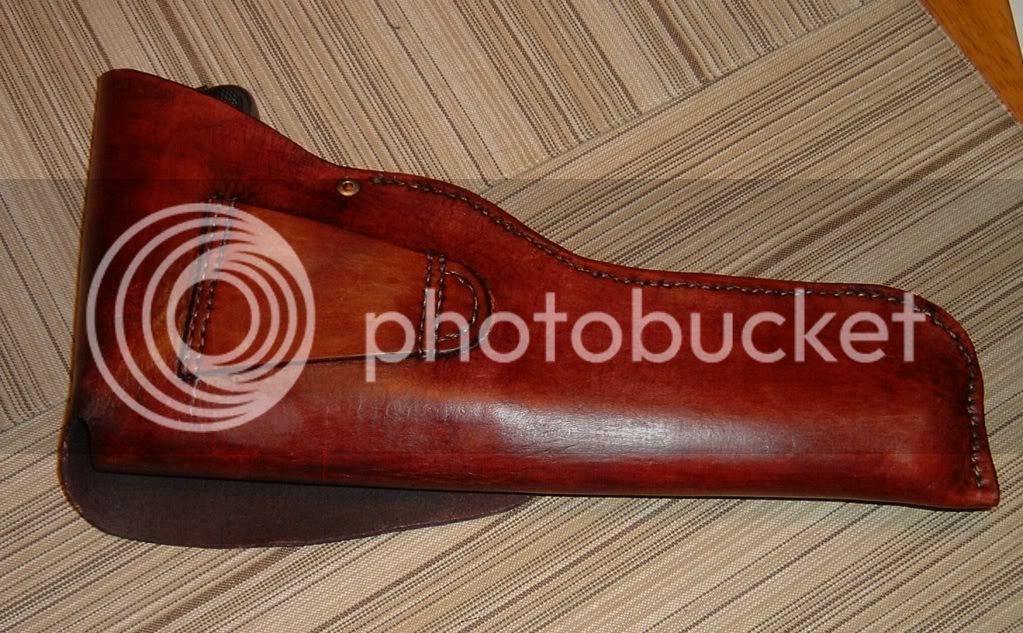

I wet formed the .44 slim-jim holster. On the .22 revolver it just folded it, and it sits deep enough i don't think it will pop out. If it wants to , I'll sell the holster and make a new one. I think the Ruger holster will easily carry a .45 1911 with no mods.

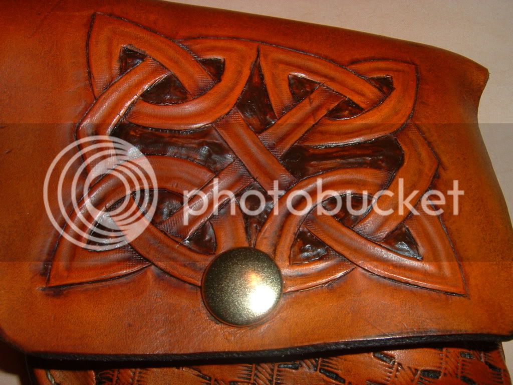

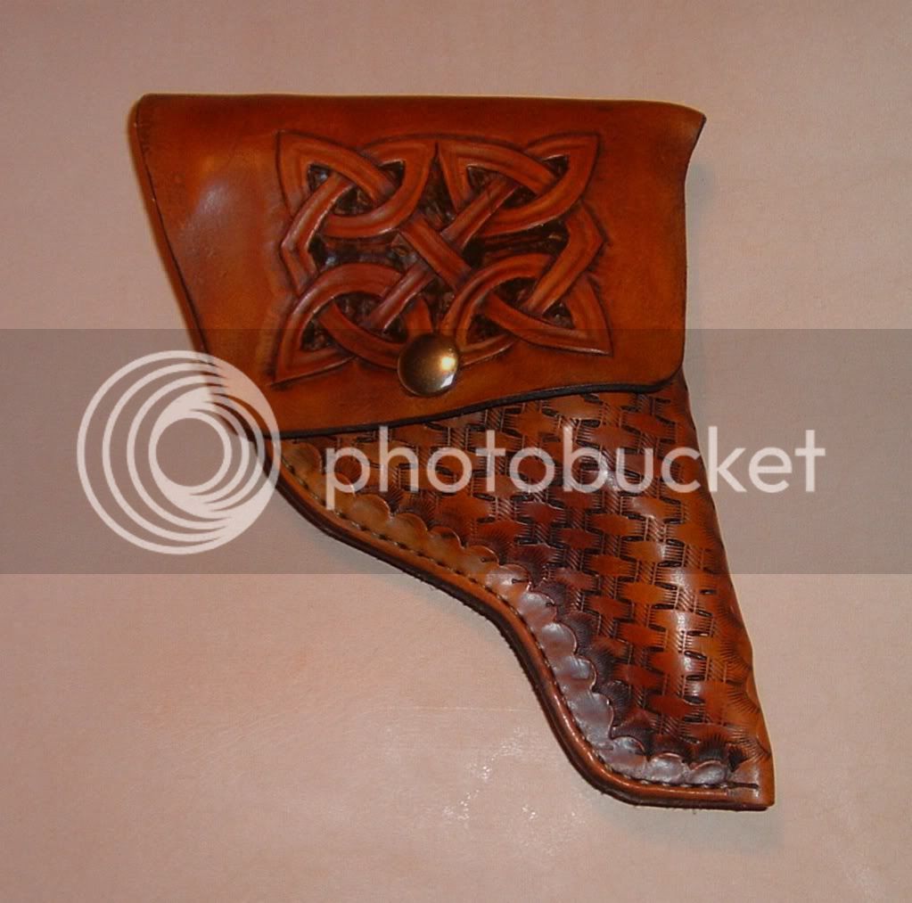

I finally got to make one for myself . It was made around my H&K .32 revolver. I like the "full cover" style for carrying in the boat and hiking through heavy brush. If I think I need a "quick draw" holster, I'll make one of them, too.

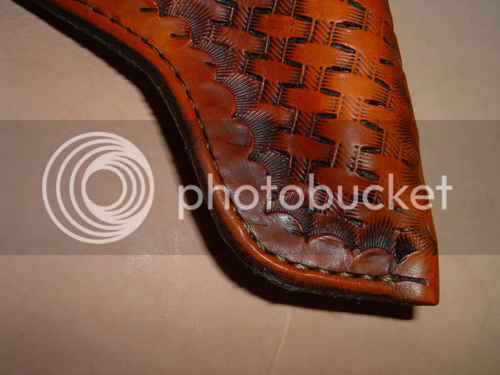

It is about 6 oz oak tanned leather, tooled and colored and then oiled. Hangs on the waistbelt just like it grew there. piper
