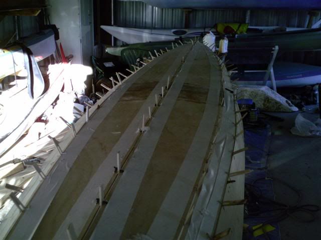

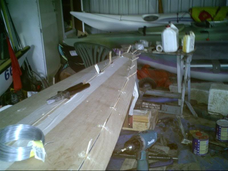

I finally got time to make a start on my boat. I gotta tell you,, The more she starts to take shape, the more impressed I am with her.
I plan to take this one real slow and make the hull as fair and sweet as I can.
Swamprat, Thanks mate :D I think this is going to be a real slippery little beast.

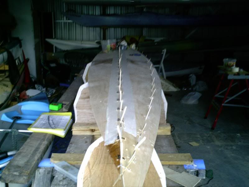

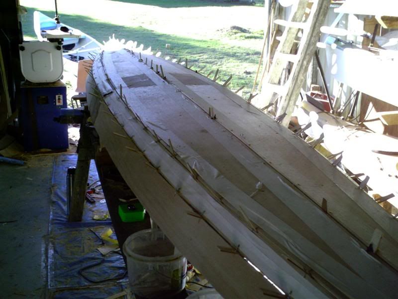

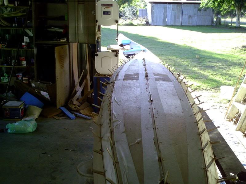

I think Matt will be a little mad at me because I am not sticking to his build instructions. I am using a strong back to help me manage with the panels and to keep everything in line and true. It works for me and I want to stick to what I know. Anyway, I got the bottom panels and the first side panel on on one side today. I hope to get a little more done tomorrow.
Here are a couple of piccies.
This one shows the generous flare in the bow starting to take shape. Should provide good lift in surf.
This one is the sern starting to take shape. lovely fine exit. Should help with tracking.
This is just a side view. should be very good secondary stability.

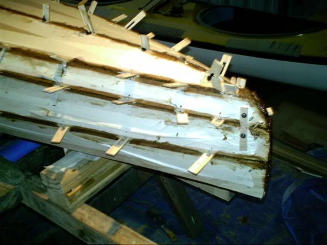

yeah mate, Spacers is what they are. They are used to creat a small gap between the panels that is filled with woodflour mixed with epoxy. Acts like a very good glue.
Full details are in Matt's website. Works a treat. :D

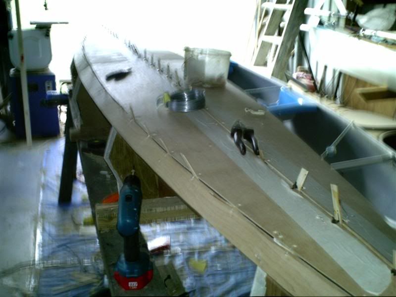

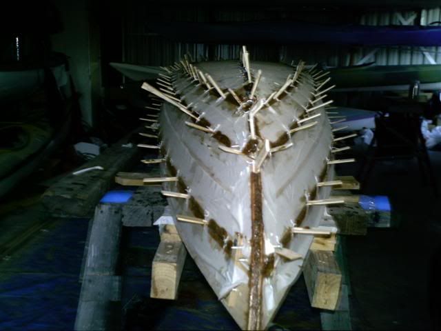

Hull panels 1,2&3 are all stitched up and true. Hopefully tomorrow, i will be able to stitch and tru the final hull panel, then tis on to the wood flour :D
A couple of piccies.

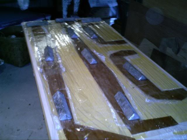

hi Bullhead,
yeah mate cast from scrap lead into ingots. Easier storage, i make my own sinkers.

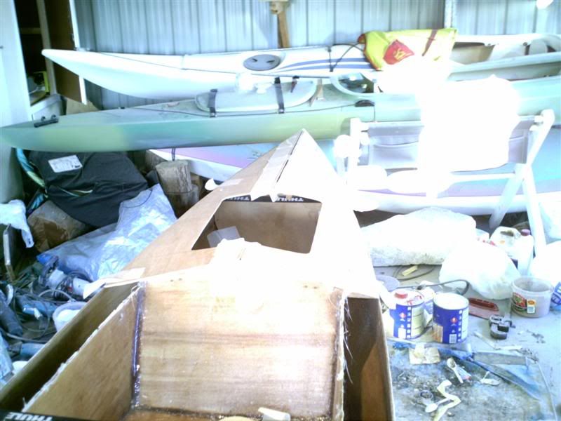

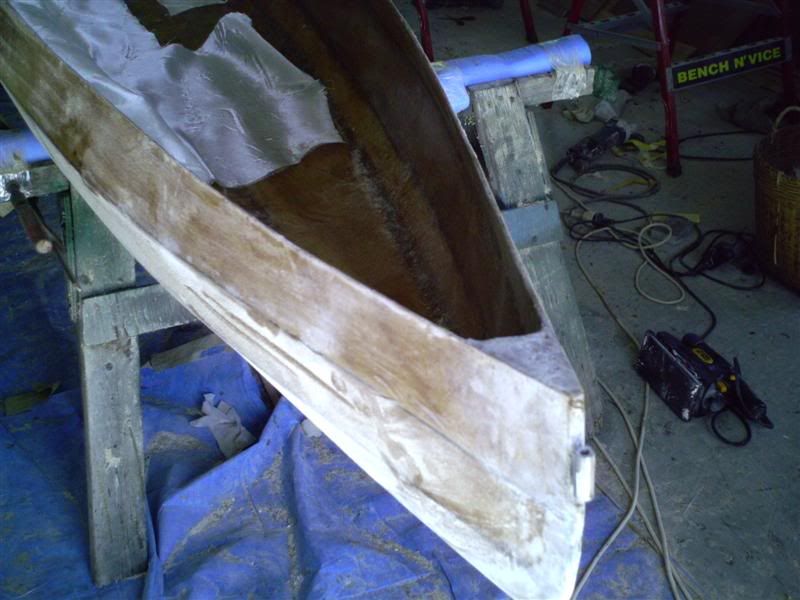

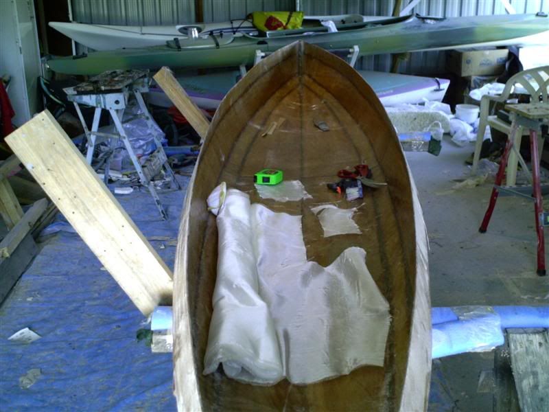

quick update,

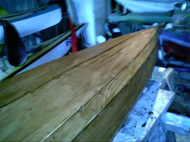

hull is sort of complete as is cockpit & supports, Started fitting foredeck and hatch. bloody trying to think about two boats at the sme time is confusing the hell out of my old addled brain..
couple of piccies.
