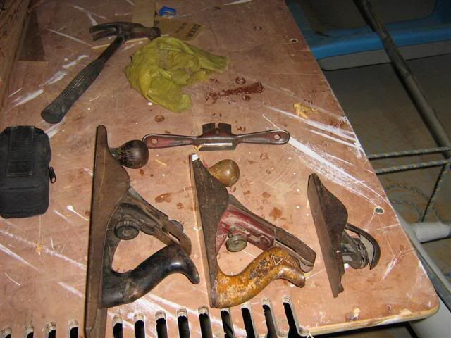

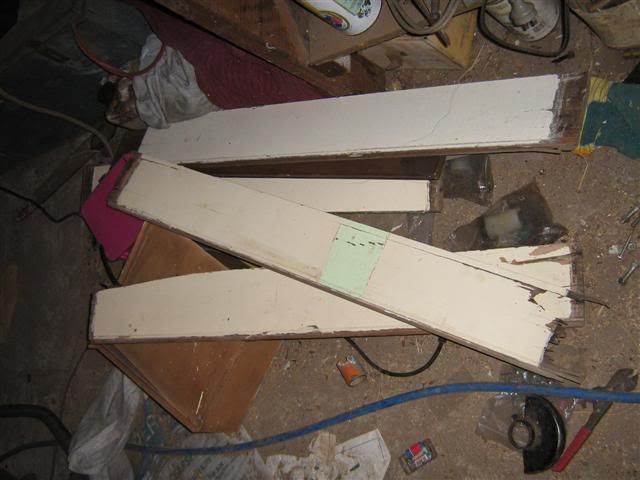

A couple of days ago, he turned up here with a box of his fathers planes, spokeshaves etc - full set :shock: that I didn't even know he had. He also had a bunch of 71/2" X 7/8" tongue & groove boards that he had scrounged somewhere. The boards were about 4 feet long, clearly very old and covered in the hardest paint I have ever seen. " Here is your paddle, boy. Oh yeah, and I thought you might like these planes. They were my Dads."
To say I was gobsmacked and thrilled is an understatement. I just love old tools and they are the only thing of my grandfather's that I have, and they are beautiful.
Anyway, back to the story, I had a rough idea of what I wanted to do for a paddle so I started removing the paint on a board and as I did so, the grain started to show though. :shock: It is hoop pine. Years ago, it was milled here, and marketed as Oregon and was used a lot in house making (solid timber walls etc) beautiful stuff and no longer available. Straight grained, knot free and just about 30% heavier than cedar but a heck of a lot stronger. I haven't had the pleasure of working with Hoop Pine before.

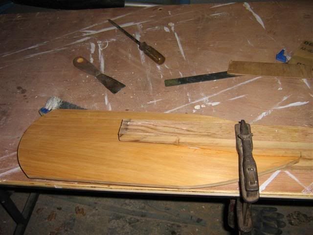

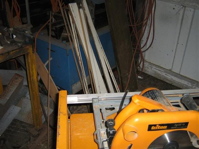

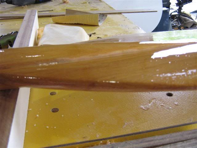

I cheated a bit, I ripped a couple of the boards down on the table saw, but after that, It was all hand tools. I am pretty pleased so far with the result. I got the first coats of epoxy on today and will post some piccies of the end product tomorrow. (The next one will be much better. :D
From this,

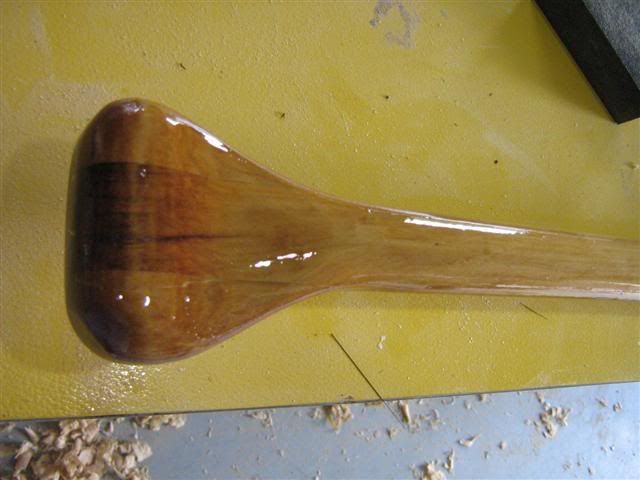

to this

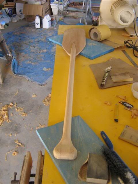

to this

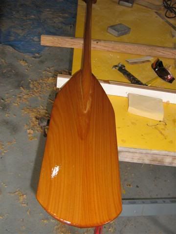

to this
Playing with these :D

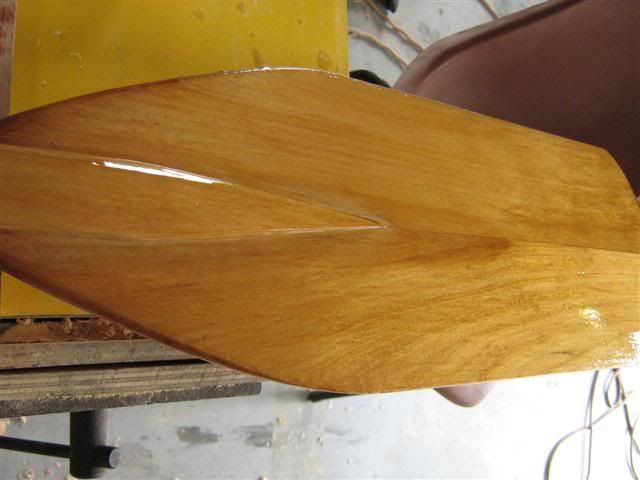

Paddle is done. :D
OA Length - 53"
Blade length - 22"
Blade Width - 7"
Shaft thickness - One and one eigth inches
Weight - 1 pound 7 ounces with 3 coats of epoxy. :D

Was the wood long enough ? or did you have to scarf the pieces to get the handle length ?

The wood was only in about 46" of useable lengths. The shaft is rebated and then laminated on to the blade. Now that the laminations have properly set up, I tested it today by resting the blade tip on the ground, holding the other end and putting all my weight on the shaft just above the top of the blade. It took the load well with no sign of failing. :D You beauty.!! :D :D
