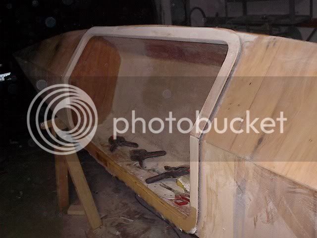

putting on combing
That was the lower combing now installing top combing

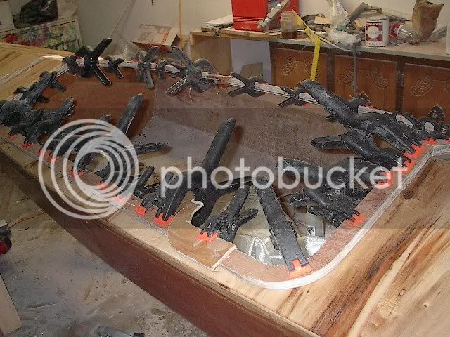

putting on layers of risin and sanding

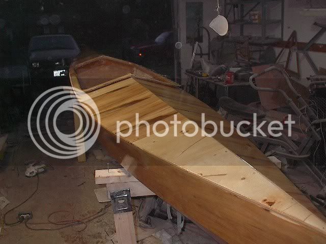

Adding coats to top deck

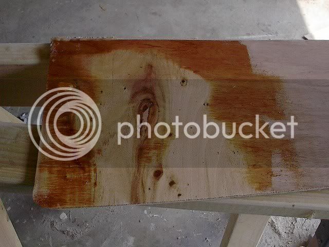

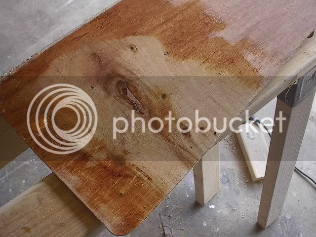

I got to fess up here The wood on the deck is laun as is the rest of the boat. I hollered for help few days ago on trying to get a good line when I put on top deck.
Try hard as I could when I made a seam on the hull I would get white on both sides in places even hand sanding
I couldn't understand how ya'll were doing it tried everything
here is pic showing what I am talking about
I finally was at wits end and was looking at a piece of scrap plywood where it had been scratched as I examined it decided to sand it and see what it looked like as I played with it figured out I wasn't sanding into another ply.
They had rolled stain or some kind of finish on to make it look like it was one solid piece on one side sort of like a film look in the next pic you can see where it soaked into the grain.
another pic this is the scrap where I cut out the cockpit
I sanded the scrap out liked what I saw went to sanding on decks with a lump in my throat.

Hi Ron,
Really beautiful boat you're building, there! I like the way you're doing the decks "cross-grain". Looks good, and can actually be stronger than lengthwise grain.
