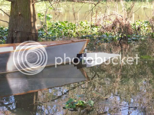

Well, maybe not REAL serious boat building stuff.
Something else from the somewhat twisted minds at Roll The Dice Fabricators. Quite crude and thrown together but it's a proof of concept.
Longer boats, on average, paddle faster and easier than shorter boats. BUT, shorter boats boats are lighter, turn better and are easier to load and unload. What if you could have the advantages of a 3 ft. longer waterline on a 13-14ft boat?
Voila! The boat extender.
Don't laugh......it seems to work. I took it out for a trial run and it seems to cruise a bit better and glide a bit farther. One other not-so-obvious advantage . When you paddle with a single or double paddle, the boat yaws back and forth .....some more than others. It might not be much in a 16-17 ft boat, but it's there. Now , when the stern swings out even an inch, it creates turbulence and eddies in it's wake. I have a feeling that this addition will help absorb some of that turbulence and turn loose of the water more gently because it gives to any side pressure. Fish tails work like this. To work properly, this addition would have to be faired into the hull.
OK, Fire away. :mrgreen:

Ok, a little carification is in order. Should have mentioned it. This thing attaches to the stern of the boat. It trails out behind it , half in and half out of the water. It gives the water 3 more feet to come together at a less abrupt angle, and absorbs any side thrust that could slow the boat.
I paddled the pirogue up and down the bayou (approx. 1 mph current) and it got up to speed and cruised noticeably better. It tracked straighter too. It still turns like a 13' boat. After putting it through it's paces for 20 minutes, I took it off and re-tested. Definitely a difference.
I don't know how practical it is, but it sure bares more experimentation. Adding 3 feet of waterline at the cost of a quarter pound of material is a pretty good feat in itself.

Joey, now that I realize the extension is on the back, I have a question. Would this streamlining aspect also serve as a rudder? With a hinge, it could both reduce turbulence and thus drag, and also provide directional control. Maybe.
Jack, it probably could. But , I'm thinking that some of the improvement comes from it's flexiblity, which you might lose with some kind of steering mechanism.
I'll get my wife to take some video of me going by so I can see it's effect on turbulence.
