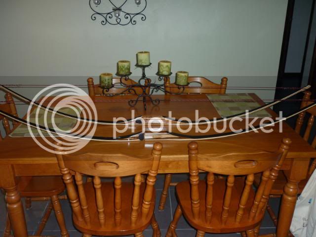

Got a couple more done now , some of you have already seen the first one but here they are

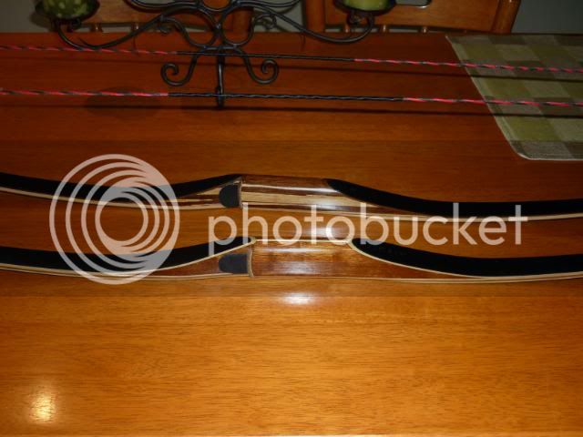

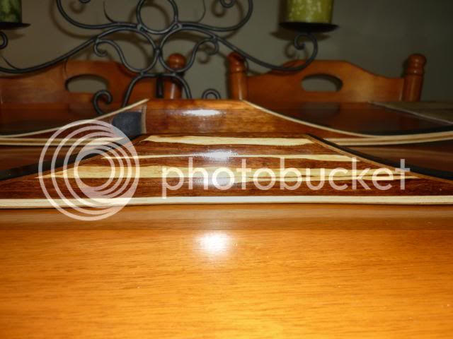

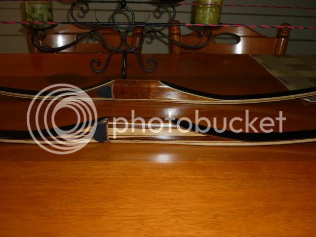

One is 65# @ 28" , 68" NTN and 70" over all , 16" riser , riser is Kwila with a vertical lamination of Tulip wood
Next bow is 55# @ 28" , 68" NTN and 70" over all , 16" riser , riser is Zebrano bamboo , both shoot well , smooth draw , no stack , no hand shock , I draw 30" and there isn't a problem with that at all , the reason I went to the 16" riser was for a slightly longer working limb for those with a longer draw length and so far it's seemed to work out well for me
