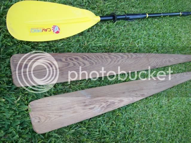

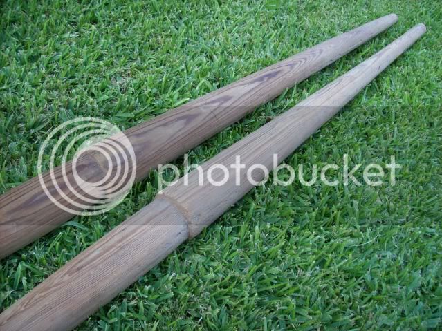

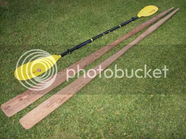

I have a pair of oars for a Cajun rowing skiff Daddy never got around to making. He had a local guy make them for him between 60 and 70 years ago. The guy that made them was the man you went to for specialty items. He made most of the round wooden cisterns around here for many years. He also made the removable jougs and oars. No power tool every touched his hands- old school all the way. When I was a kid ,the old store the my daddy bought was torn down to build a new one, this old guy came to clean up the lot with his horse and 2- wheeled cart, which he probably built also. The oars have been in the water once in all that time. They have a finish straight off the spoke shave- no sand paper.
Notice the similarity of the blades to a Greenland paddle. Same priciple developed by people seperated by an entire ocean. 8)
that top oar haz some mitey fine grain in it......mebbe ya oughta build a boat like the one Keith 'n seedtick been workin' on ta go with 'em? [grin]

That's one of the phenomena of the paddling world. There's more variation within various groups of boats in Alaska, and within groups of boats in Greenland, than there is BETWEEN the groups of the two, widely separated areas. This proves the wisdom and intelligence of our forebears in these locations and times.

Seedtick, here are the specs:
length : 107"
blade width : 5"
max. diameter( right above the pivot point) : 2 3/4"
grip diameter at end : 1 1/8"
I had a nice visit from keith and seedtick yesterday. They came by to check out the oars first hand for a set they're building. I had never really looked at them that close, but the thought that went into the design was amazing. The cross section shape goes from round at the grip, tapering up to about 2 3/4" right above the pivot point. It necks down to about 2" round and gradually changes to a rounded diamond shape right above the blade. It flows gracefully from the diamond shape to the flat plane of the blade. Very subtle change in shape with no hard transitions. This was not this oar maker's first rodeo.
