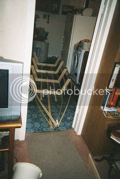

The kitchen and lounge needed redoing,my wife was away on a conference,so I decided to build a boat quickly before redoing the aforesaid rooms.
As it was cold,I built inside.

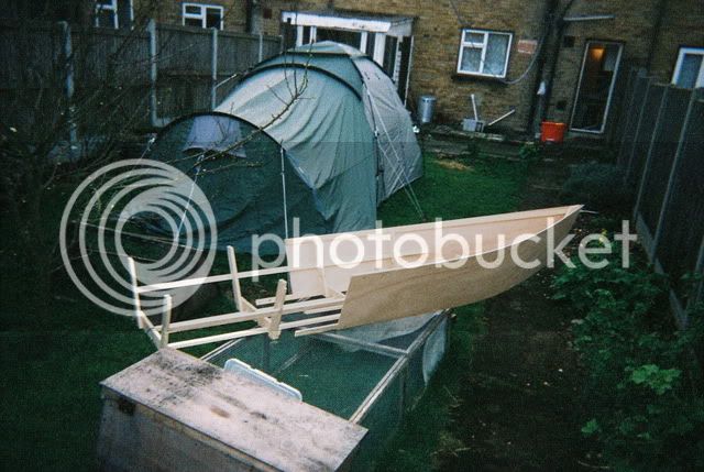

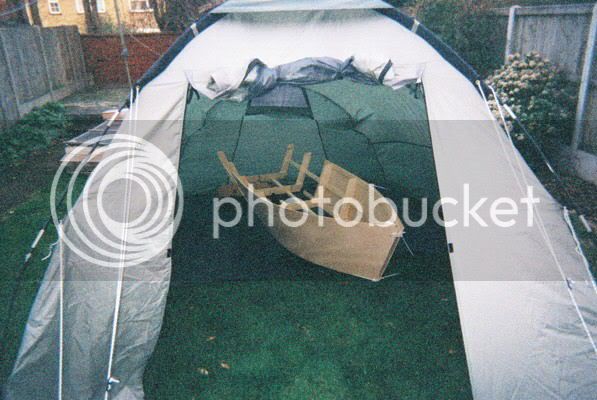

And into a tent.Inlaws,outlaws and work colleagues thought that I should join
the boat,but my wife was pretty chuffed with the project,although not the original build site
