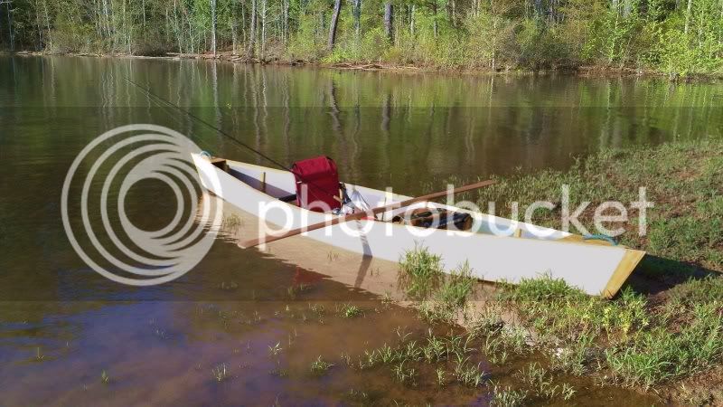

The designer of this boat has had someone build one. I don't know all the particulars, but I did get a picture forwarded to me. I've got an email out to the person of interest asking for more details. All I have now is this pic:

How cool, that is my boat on Black Shoals lake in Rockdale County, Georgia. I built it according to the information on this web site and from Herb Cottle's. She 13'8" long, 22" wide at the bottom, 29" at the top, and 35# dry. She flies thru the water with my homemade greenland paddle. I had trouble finding trim coil so I used aluminum gutter coil instead. The ladders are made from 1x2 cedar strips( I didn't have a table saw) joined at the ends to planed cedar 1x4. I used a Kreg Jr. jig to attach the ladder together and left the screws in. I probably will take the screws out after the epoxy hardens and glass the inside facing joint like Herb's next time. The bottom is 1/4" exterior grade plywood scrafed together with 1x4 cedar strips for a keel. I will use a butt joint next time. I glassed the bottom outside edge per Herb's suggestion. The next one I am going to widen to 24" at the bottom and 32 or 34 at the top so I can stand.
