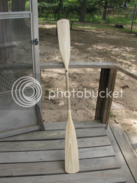

A "bright" idea gone dim. Thought I would make a short double paddle to ease the boat along while fishing. Could be used as a single paddle but would not have to swap sides of boat. Just pick it up and paddle on which ever side of the boat you needed to. Did not work too well in practice. Not the first time my ideas didn't pan out. It was still a lot of fun to make and I need the practice. 2X6 cost $.50 from the cut off bin so no big loss.

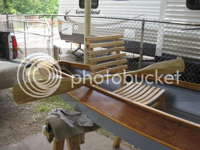

I thought it looked good on the boat.

Go ahead J.D. spend another $.50. Ya know your going to have fun with it. :D Could your grandson use the paddle as is or would you have to trim it down a little? It may not do what you intended, but it still looks good.

Another thought, it is about the length of an Inuit paddle. Narrow up the blades and let the Grandkids use it.

I agree with the other guys - a perfectly reasonable looking paddle except for the length.

I know it is too short to be used as a double kayak or Inuit paddle. The thought process was for it to be a double ended paddle used as a single paddle over either side of the boat with out having to switch the paddle from one side to the other, or to use it one handed for a single stroke to ease the boat along as I fished. It workd, but not as well as I wanted. A lighter and/or narrower design may be better.

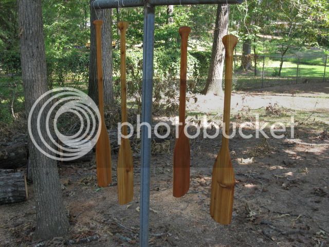

I'll hijack or drift my on post. I have seen those thumb paddles. They may work but, not in the manor I envisoned. A lot of pirogue paddlers around Lake Bistaneau use two short (36" or less) paddles. One in each hand, (thumb on top side of fist) held at the shaft next to the blade. The stroke is a grubbing motion (reach forward, stab paddle into the water and pull rearward), alternating left and right stokes. Only one paddle is used when casting or other activities. I don't have any pictures but I will try to get some and post. I did not explain this well, but the two short paddles in this picture are being made for that usage:
:wink: Jack these cut off boards are more expensive. Each paddle has $1.02 worth of wood. I was kind of nervous getting started. :roll:

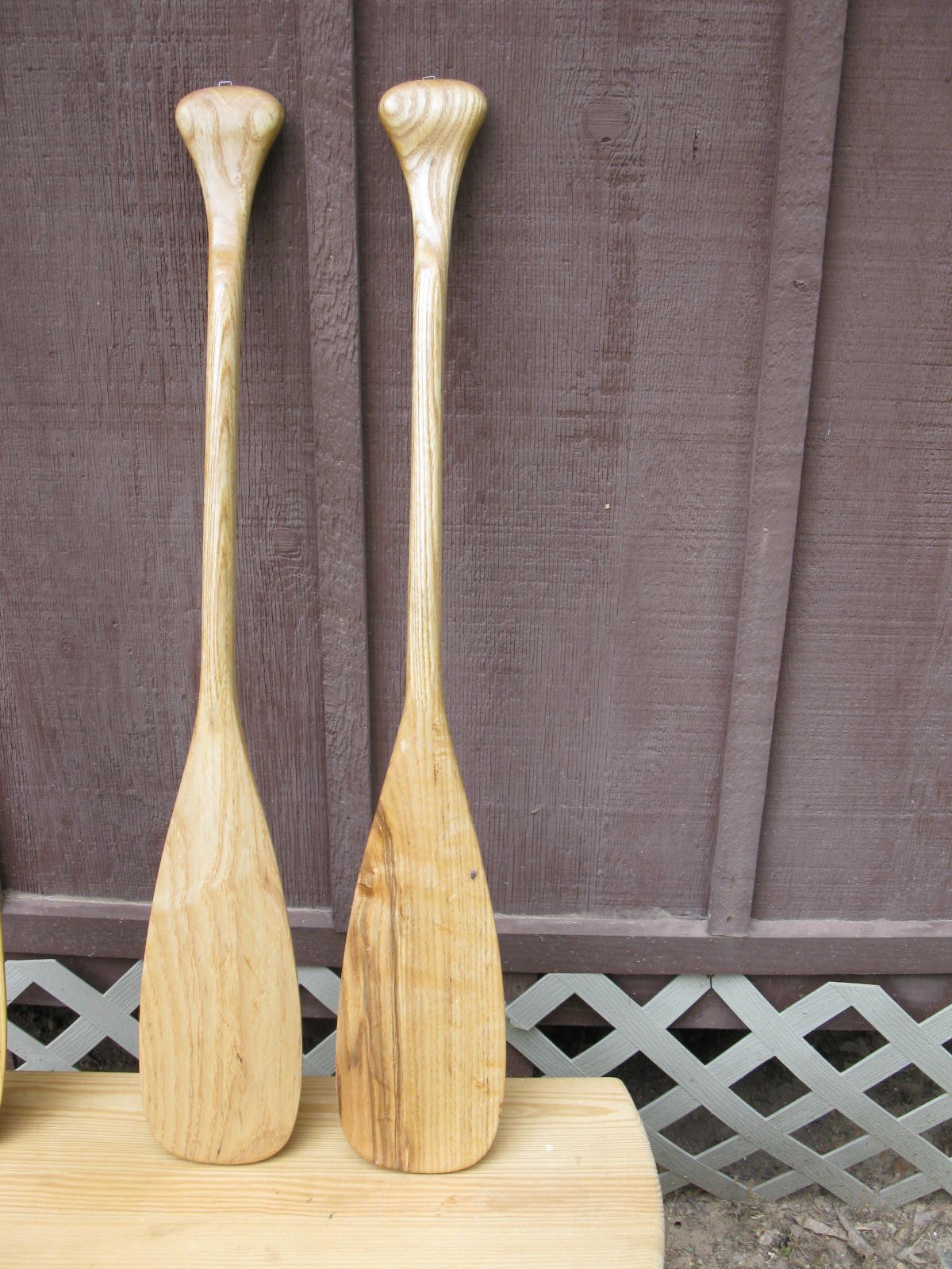

I made these two "short" paddles with the idea of using them as you described.
They are 36" long and have "oversized" grips for my large paws. Do you thing they are too long? If I shorten them by cutting the grips off, would they still work?

That's kind'a hard to say, I've considered trying 3' paddles but decided they would be too long. I'm sure that cutting off the top grip would not work. I use the knob to "hook" on my arm just below the elbow. This morning I was starting to repair a pair of 2.5' paddles and was trying to figure out how to turn the knob into more of a hook. Jack once made reference to a similar paddle for sculling.
I'm toying with the idea and build a pair with at least a wider knob. Just resistiing making a paddle :)

One possibility would to cut the grip off, turn the shaft round on the end, then bore a hole into a dowel to make a T grip. It could be made as long as you needed it and it could even be asymmetrical if that would help. If you didn't use glue it could be changed out until you figured out what size worked best.
