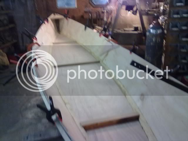

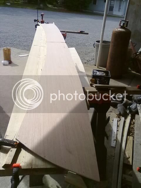

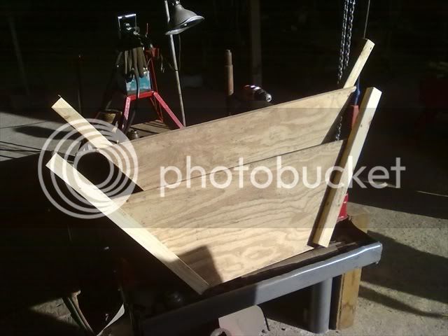

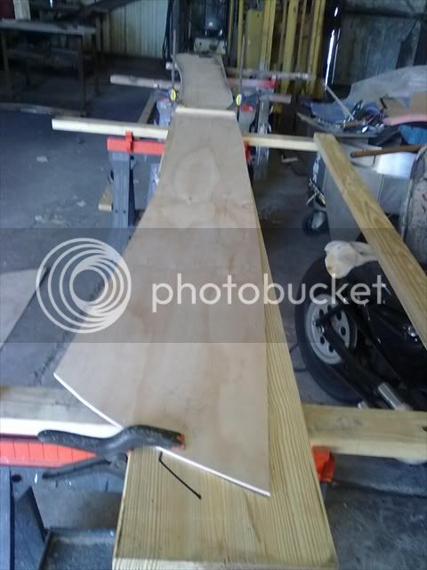

Sides cut and glued

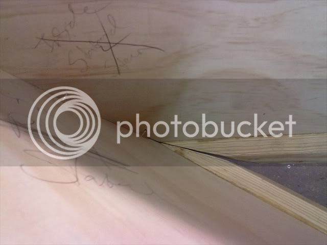

inside chines added and glued

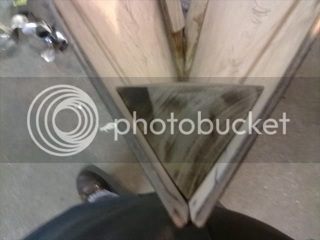

Stems installed

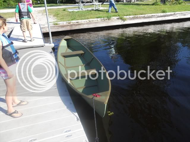

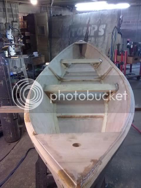

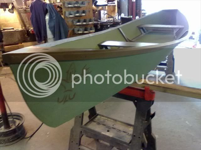

Just some info: 15'3" long, 12" sides in center, 25-26" at bottom, and 39-40" at gunwale. I used 4 or 5 mil luan for sides and 3/8" for bottom and cypress stems, ribs, and decks. I used brass screws that my late grandfather had purchased over 30 years ago, so it's like he's riding with me. It has about a 35 deg flare to the sides and about 3" rake in bow and stern. Here's some more pics
The finished front
Launched
Maiden Voyage
Fully loaded 535 lbs, still has @ 2 inches of freeboard

Did you use plans, or how did you determin how much arc to cut out of the sides?

I use it in the marshes of SW Louisiana, so I wanted a pirogue with not alot of rake and decided to go with a 6" swag cut out of the bottom. A challenging part of the build was forming the stems, I used the post by Seedtick on how to make them, but overall it ended up somewhat different. But the HARDEST part of the build was using a slow hardner for the epoxy, i had to scrape the epoxy off the bottom 2 times before I got a fast hardner that worked.

Waited 2 days for it to dry, scraped it off like uncured paint. It came off in layers to my disgust, I was using Donovan Marine's MARPRO hardner because I got wholesale prices....boy was that a mistake.
The stems taper twords the bottom of the boat and are really thick near the decks. They don't stand proud like on some of Kieth and Seedticks stems, I just kind of worked with what I had.
By the way the pirogue weighed before epoxy 61 lbs after epoxy and paint 72lbs. I'm still fairly strong :D and can carry it by myself over my head....for how far I Don't Know>>>>>
